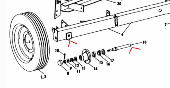

Loose NH Baler Wheel Spindle
Posted by farmallboy15 on June 25, 2020 at 04:31:51 from (170.103.146.54):
I recently purchased a pair of NH 273 balers. I was told that the PO had trouble keeping lug bolts in the one wheel hub. It turns out, that's because the wheel is cracked. After digging a little deeper, I found that the spindle has about 1/8" of slop where it goes into the axle tube. Has anyone ever had this happen? How did you repair this? My thought is that the bolt holding the spindle to the tube has some wear/slop to it. I plan to replace the bolt, if no improvement just weld the spindle to the tube... The bolt location has red arrows on the parts diagram.
