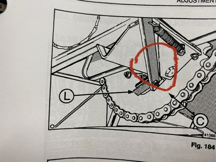

Of the new Holland D1000 . Needles will hopefully Be here soon but still got to get the root of the problem fixed . The needle safety latch is wallered out and that�s what�s causing the grief of shearing pins every time the knotter tries to tie . Good ol new Holland put a roll pin in that you can�t see and you can�t get a good swing at I�m about ready to cut an access hole . Once that�s apart I can get it built back up and have a working baler again
This what�s wore out
