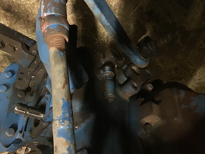

If the 8600 is like my 8000, there is a small, separate sump for the PTO gears/ stub shaft. There is a fill plug on the left side that takes about 1.5 to 2.0
gallons of UTF. You�ll see mine has an elbow and riser for easier filling (just behind the rock shaft )
