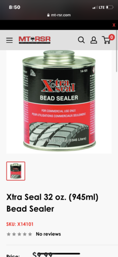

The shop used bead sealer on mine and so far they are fixed
never could get them to seal before that never would hold air
and only on the rear duals the fronts will go the life of the tire
and not leak a pound . Next time they come off I�m going to
clean up the rims and prime and paint the entire inside
