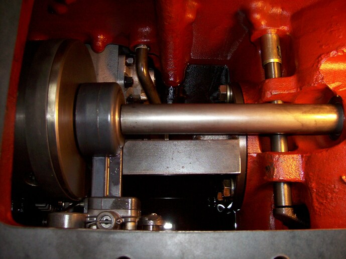

If you have the top cover off you may want to add this kind of a fix as well. Friends 5000 had a bad pto clutch and I found that the aluminum part that went over the PTO hub to deliver the hydraulic pressure for the clutch piston, would drift to the back. So I welded up a bracket that would bolt to the back bearing cover to hold it forward. Yours may not need this. Just thought I would throw it out there for you.
