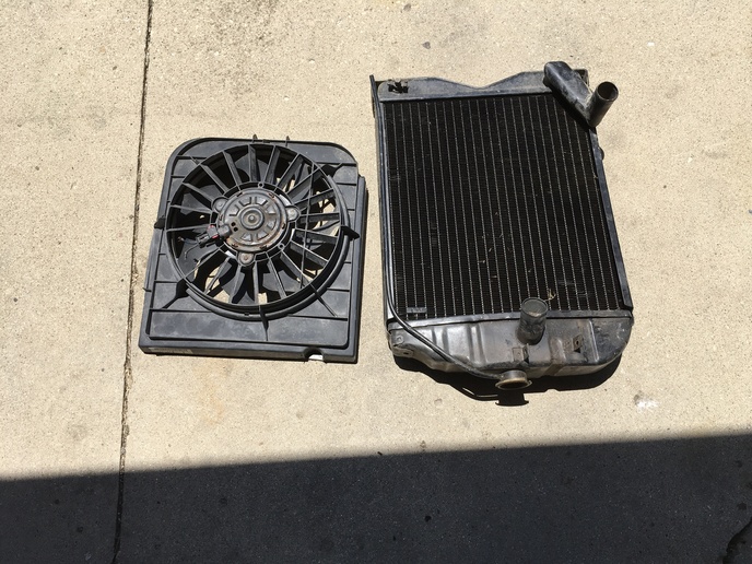

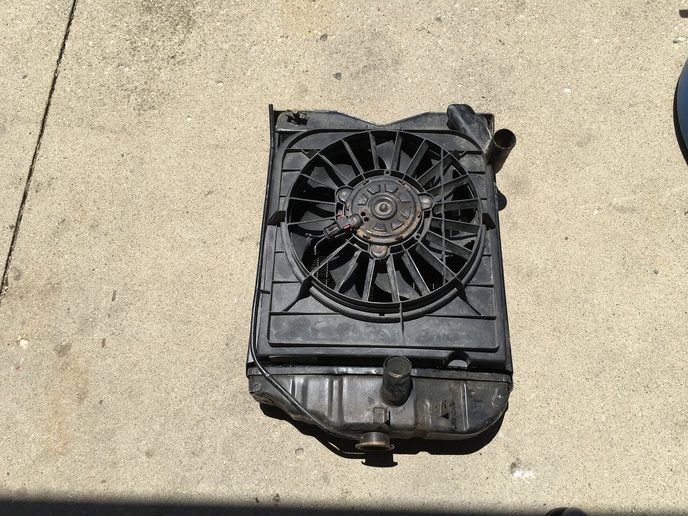

Posted by glennster on June 06, 2020 at 10:29:16 from (99.90.9.201):
aquired a to 20 a couple years ago that was field ready according to the prev owner. after throwing about 2 grand or better, at the lil fergie i got er going. brush hogging in hot weather the tractor runs hot because the rad shroud is missing. tried to find one with no luck, was going to fab up one but looking thru my assorted junk i found a chrysler cooling fan that just fits perfect within the radiator. will mount with some foam insulation and a couple pieces of pipe hangar galv strapping not stock, but it will work!
