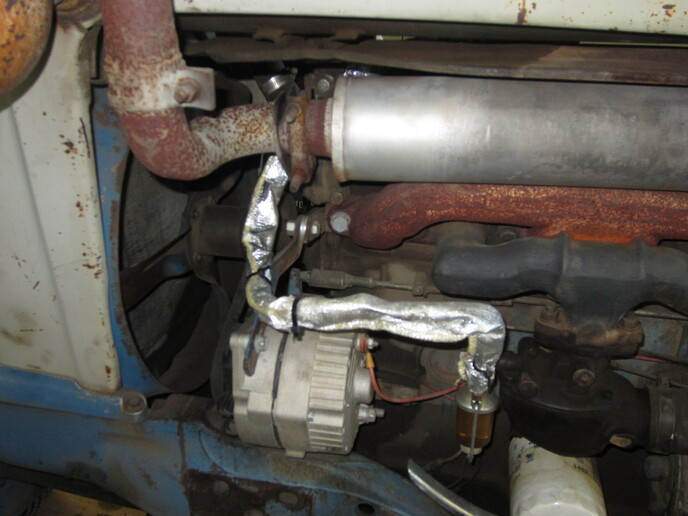

rerouted fuel line on Ford 4000
Posted by bjasa on June 05, 2020 at 05:21:30 from (70.59.161.85):
Enclosed is a picture of the rerouted fuel line on my Ford 4000. I covered it with a heat resistant sleeve and after mowing, raking, and moving bales this week in the 90+ heat, I had no issues. Thanks to Greg1959 for posting his picture earlier, it helped me. Thanks
