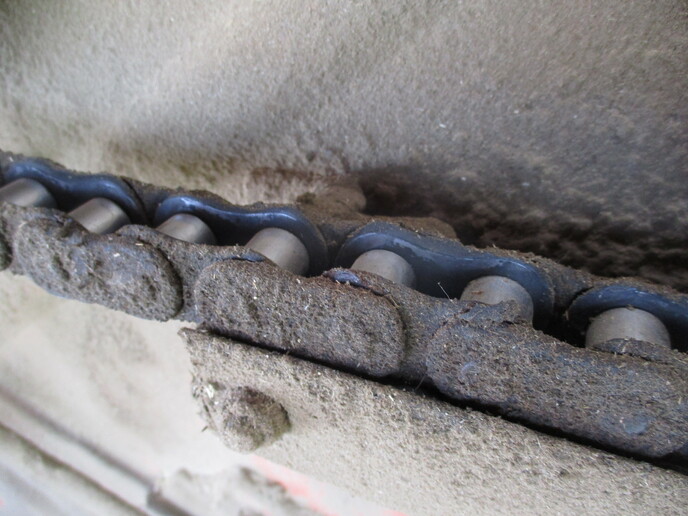

Pete below has found out what I have known for many years like he has, a Warm chain will allow the oil to soak into the chain and last,, cold lubing it just flings off a majority of the oil,, i have tried chain lube,, and some are pretty good for sure,, some not so much but all cost more than even the cnh HD 1-40wt dsl engine oil I use,, all my testing has shown it will stay on a chain and or any thing that has movement for much longer than any other oil, but for sure oil them before you shut down for lunch or the evening makes a world of difference
