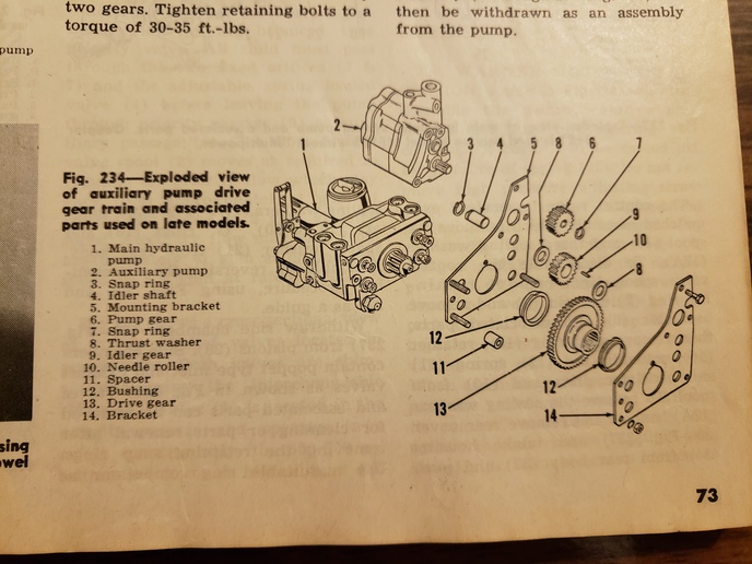

Main pump powered the 3 point hitch
Aux pump feed to remote rear outlets and
IF so equipped multipower and independent
pto.
Pic is mf175-180 later style.
Similar for all 100 series
