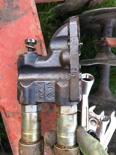

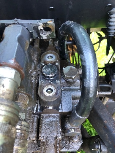

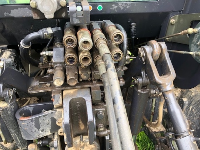

Was discing with our Landini Vision 105 and snapped the hitch pin on the discs. They stayed and the tractor kept going. Stretched the hydraulic hoses to their limit, they didn't release and the top half that set of remotes on the manifold unit (there are 4 sets of remotes) broke free. Here are pictures of it. In the picture it is the pair on the far right. I can't find a parts breakdown for it.

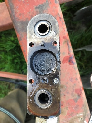

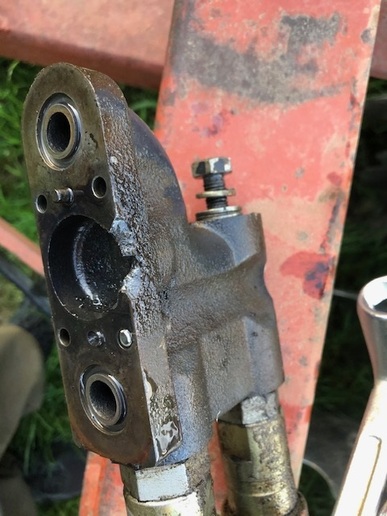

There are 4 allen-headed bolts which hold the 2 halfs of the unit together, they snapped. If you engage the hydraulic lever for that pair or remotes, fluid shoots out but if not engaged, it does not. The other pairs of remotes work fine.
Can I still use this unit? Or do I need a new top half for the one? Or do I need an entire new unit? What do you even call it? Manifold? Multiplier? Each set of remotes has a line running out of it and there is a line running in/out of the whole thing.
If repair is an option:
Obviously, I replace the bolts that held the unit together. The bottom halfs of the bolts have just enough metal sticking up that I think I can get vice grips on them. If not - drill them out? Extractor? Any recommendations?
It looks like an O-ring or rubber gasket of time kind goes in that recessed circle on the bottom of the unit? Am I correct? If so - any o-ring that fits or something special? The middle part of the housing appeared to break a little - I assume fluid does not pass that area, so it probably is no big deal? Thanks in advance for any advice.
