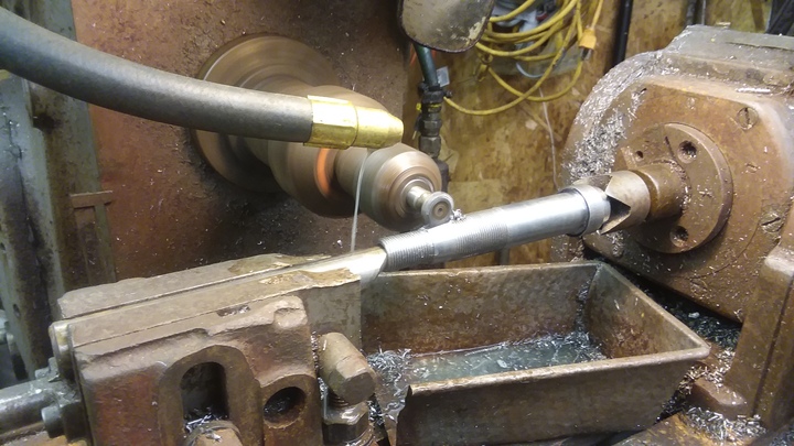

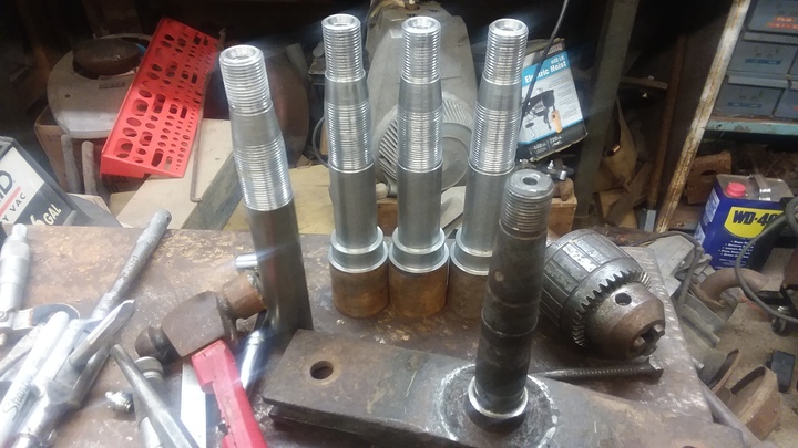

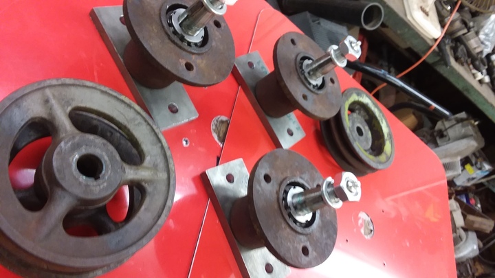

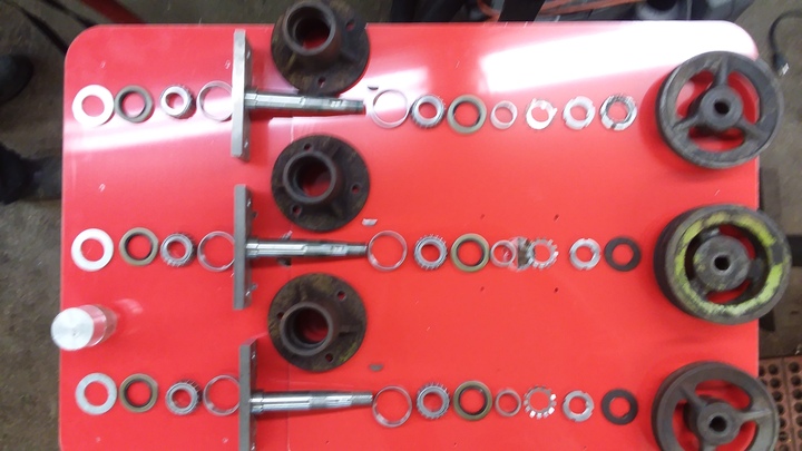

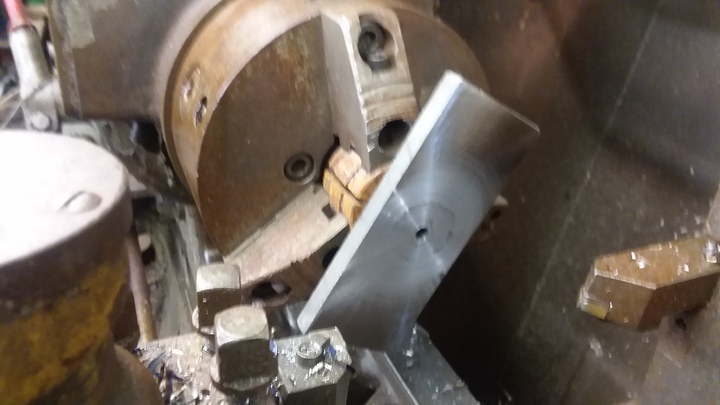

A few weeks back I posted asking about the hardness of mower spindles. Well, here they are! The spindles were made from 4140 steel, precision ground to 0.0002 inch tolerances, and after mowing 12 acres, they run cool as can be. The original mower blades were segmented, so I adapted left hand woods blades to work. I had to use solid carbide tooling to drill new holes in the blades as they were hardened.
