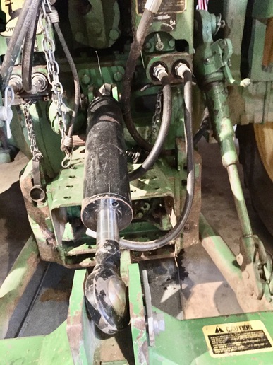

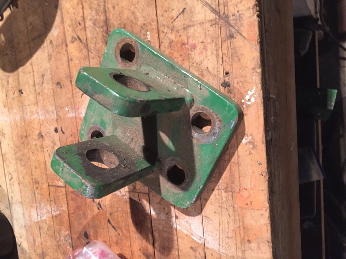

This is a hydraulic top link made by Prince - also had a Dayton. They aren't typical hydraulic cylinders but are made specifically as top links. Did have to make a new bracket on tractor because of the depth. It does not drift.
