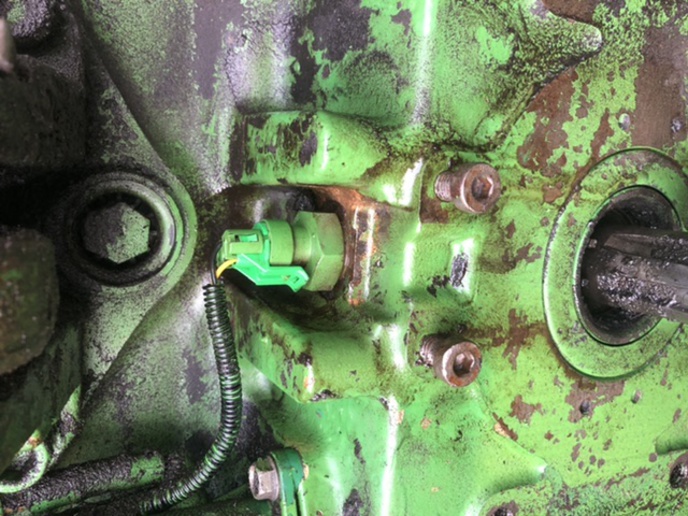

This is assume is the speed pickup sensor you mentioned.
I blew it off with air this morning.... covers in grease and dirt. Wiggled it and turn on tractor and engaged switch. Pto started turning and was operating faster and slower with throttle.
Did this a couple times.
Came back out after coffee to put covers back on and it won�t work again.
If I take out the sensor connector and run a wire between them should it run?
Or should I just replace sensor.
Anything else I should try??
Thanks again for the advice. Grant
