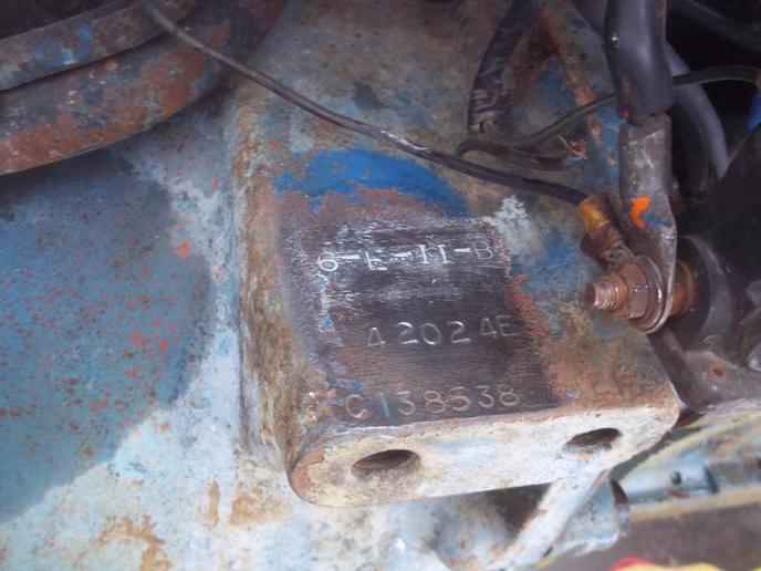

If you mean the clevis on the front end
of the clutch rod, I was going to mention
that but it's kind of a can of worms.
On the older 4 cyl Hundred Series
tractors a two hole clevis is a good
external indicator of the two stage
clutch.
Not so on the Thousands. Older ones -
1965-68 or 9? they used that two hole
clevis. Later ones they did not.
Then again some folks with a late 3000 or
an early 80s 3600 say they have the
double clevis which I kinda doubt but who
knows?
One thing I've learned about these Fords
is to Not say never or always cause you
end up with egg on your face so I didn't
mention the clevis.
The only Positive way to tell is with the
model # which is Hand Stamped (not cast
into)
on the bell housing just above and to the
rear of the starter. Bring a jacknife to
scrape some paint/crud to see it.
There is a good website to help you
decipher it at the link below.
