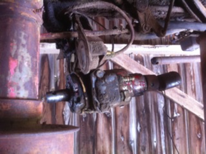

In Reply to: Farmall M power steering issues posted by glandries on May 04, 2020 at 15:57:14:
Welcome to YT. Let me see if I can direct as to the correct connections to the torque generator. Looking at it from the front the fitting the most clockwise is the low pressure port. Let�s see if my greasy picture will load. Seems as though it loaded upside down on my IPhone, but you can see what I mean, low pressure has a hose barb. This is the way it connects on my working tractor.
