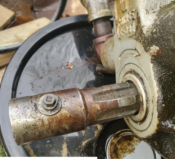

I've recently bought a Sherman Power Digger 54B900. The Prince HC-PTO-4 pump seems to work correctly, as I did get most of the cylinders to operate. The pressure gauge showed 500 psi but also stuck afterward, so I plan to replace that anyway. The pump has a PTO adapter/mount that bolts to the back of the 9N, which is great. However it's 1 1/8"; I just bought a new 1 3/8" PTO unit from YT. I did slide the 1 1/8"-to-1 3/8" PTO adapter into the other side of the pump to verify size. But... I can't use my new PTO unless I can get the current PTO adapter/mount out of the pump. What the heck holds it in there??
