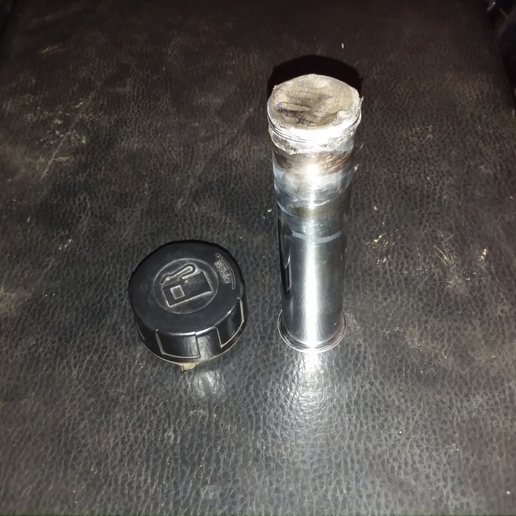

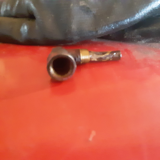

Mower down south. Farmall would run fine for
About 5 minute then sputter. Sputter would go away at an idle.
This is the third time this has happened.
First time the Jubilee. Second time terramite. And now Farmall.
I do my very best to keep fuel clean.
Use metal funnel with screen.
I made a filter for mule using an 1.25 brass drain pipe. Just fits perfectly.
This is a pic of terramite after I bought it from a DIY rental place. So I don't get credit for this. It's odd this 90 choked and no screen.
