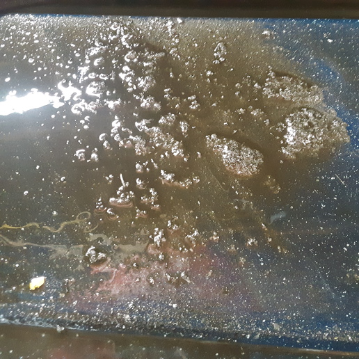

My limited slip disks broke, damaging the gears.
Pic is a small amount of the metal filling I've removed.
Impossible to remove bearings without a special puller.

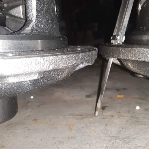

The old carrier on the right,
New carrier on left.
I need to make new carrier same height as old.
Another video shows easier way to get this done.
I'm learning a lot watching others rebuild dana rear ends that have no crusher washer or crush spacers.
