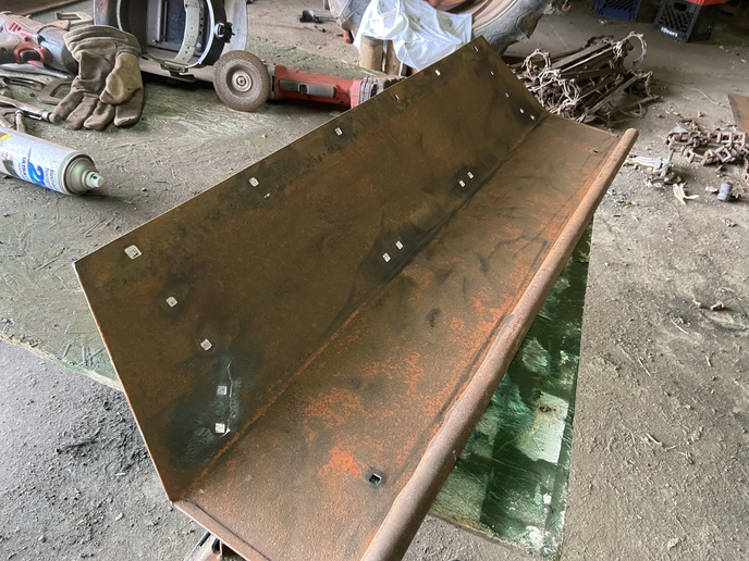

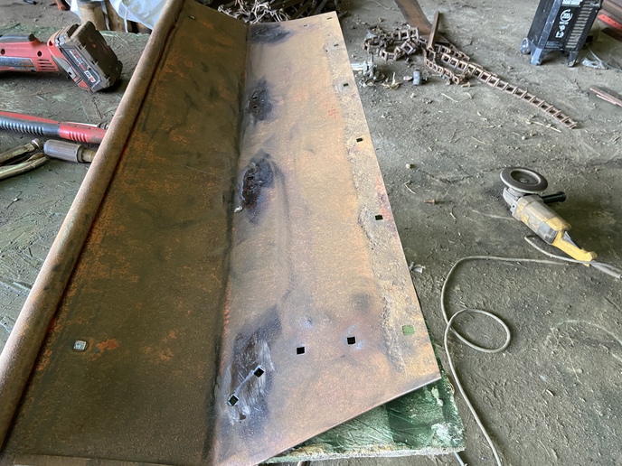

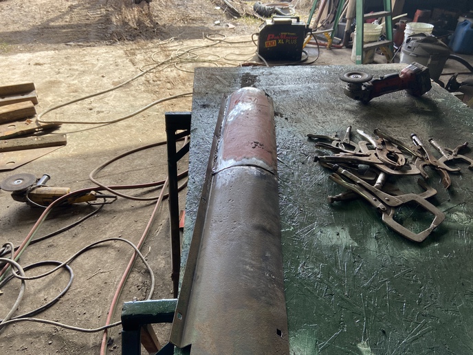

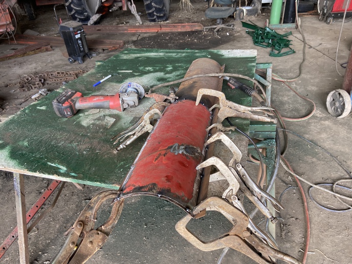

Speaking of projects, made some progress on the manure spreader yesterday, as usual not as much as I wanted. Worked on patching the rusted parts. Cut a piece out of the old header to patch a round shield.

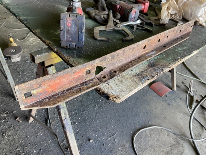

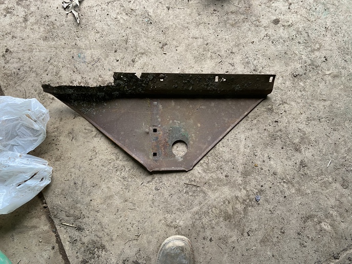

Two of the angles that carry they rear beater were rusted badly, so they got replaced.

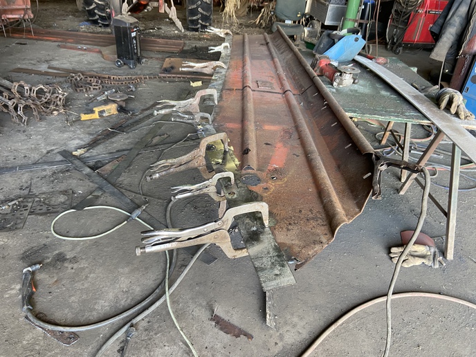

Guess I didn't get a pic of those done. I had cut the old bulk tank apart to get it out of the milk house and it had some shapes that worked for some parts, so I cut that up to patch the rest of the pieces.
The upper lip of the tank had an angle that was just right to fix the parts that hold the upper beater.

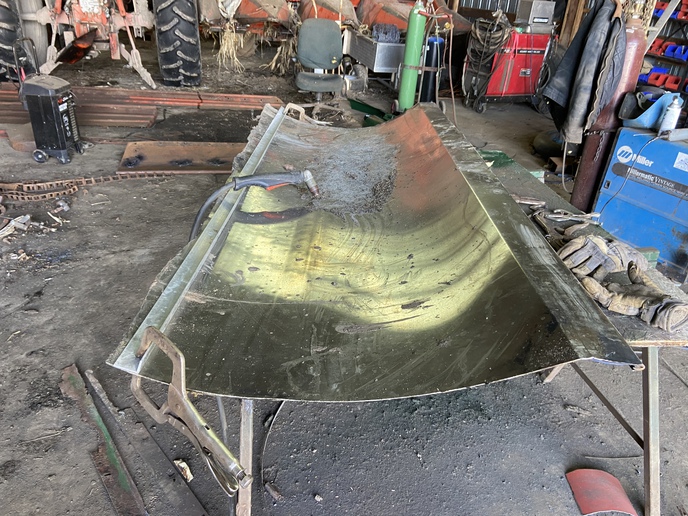

The front panel had some fatigue cracks that needed fixing. Sure is tough trying to weld thin rusty metal, especially with a welder set up for heavier work.

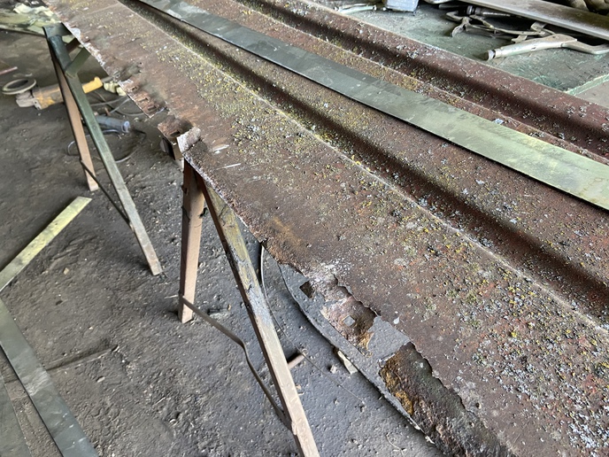

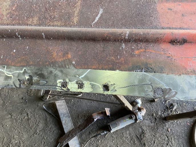

The last part is the sides which are rotted all the way along the bottom. Used the long strips of stainless I cut from that piece above to make patches. Lots of square holes to cut for carriage bolts with the plasma. I'm not as good at it as I was, out of practice I guess.
