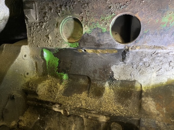

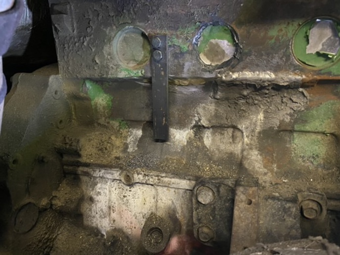

Got all the overlapping plugs installed . Tomorrow I�ll vee the crack out and fill it beck up with PES expoxy it�s a cheaper version of bellzona . Followed there instructions on reinforcing the crack I tried the pipe but it just didn�t fit like it should I went this route .
