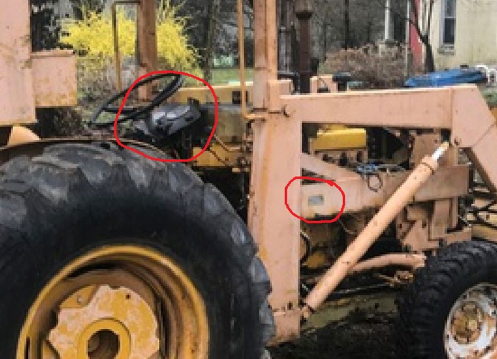

That tractor is a curiosity to me. Some things have a resemblance to a 2504 but others do not. I have a 504 which is same as 2504 and I know for certain that 504 2504 404 2404 424 2424 2444 do not have a universal joint on the underside of the power steering hand pump. I looked at many tractors on Case IH parts website and found none that do have a U-joint beneath the hand pump. Can you make a close photo of the steering wheel instrument panel area and the small square seen on the side of loader frame in the picture below? Also pictures of the rear axle, brake housings, front axle or any other areas that we can possible recognize some feature that could lead us to identify that tractor. I have IH loader parts book and there is no loader that looks like yours in the book.
