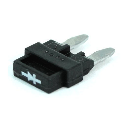

I use the GM "fuse type" diode. It looks just like the standard mini fuse. You wire a covered inline fuse holder- available at any parts store- into your alternator's triggering wire circuit, pop in a diode(correctly orientated...) and go.
You can buy them online, at your local parts store or GM dealer or get them for a dollar a handful at your local junkyard.
