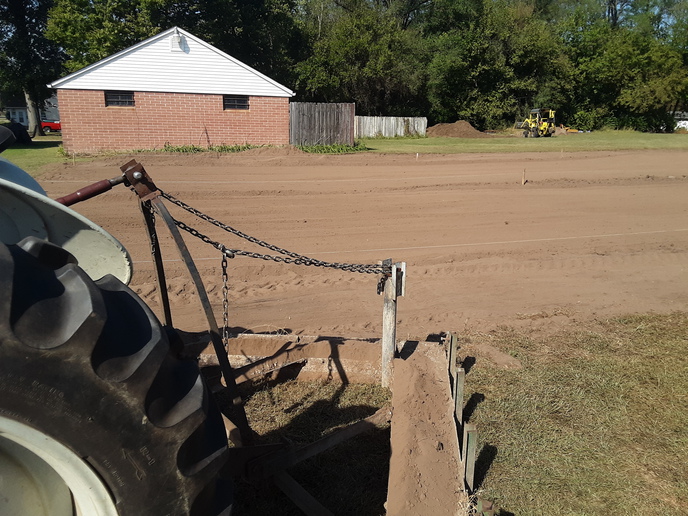

I made a 3 point V-shaped leveling device.
It does a great job, but you will need lose gravel if you want to repair a road.
I used to level the dirt when building the pole barn.
If you drag this across lawn, it will remove the high spots and fill in the low
spots.
