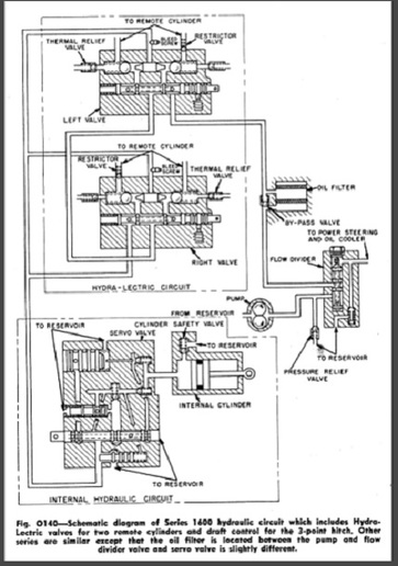

red, I understand all that. The remotes and servo valve are in series on these so it's not really much of a change. Here's a schematic.
