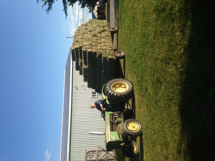

You have 2 clutch plates in there it is a dual disc clutch. I have a 710 and a 510. I believe they take the same clutch plates. Last one I did was in the 510 and I got the 2 clutch plates at dealer but they could not get pressure plate. I have heard from someone that even the discs are nla, but have not checked myself. My first call if that was the case would be to Diamond Farm near Brighton Ontario 613-475-1771. Ask for Lance. Great guys to deal with. Good luck. PS 710 is a decent tractor. Lot of people bad mouth them, and ya hydraulics are not great, but very handy tractor and sips fuel.
