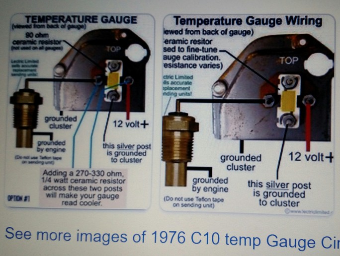

Hello courtland1949,
Not all gauges use the resistor, which is used for fine tuning the gauge. Theeft licture shows another resistor for calibrating thd gauge,
Guido.
