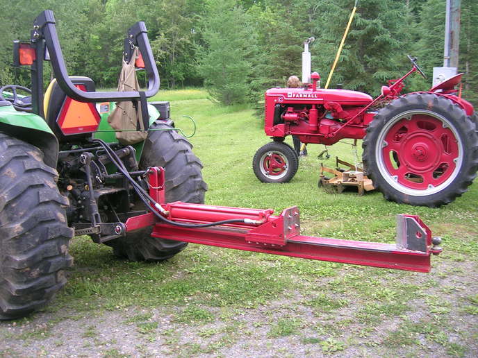

Most folks use a 4 inch, and a little longer stroke that your wood. I bought a 3 1/2 X 24, I stayed with the smaller dia. to speed it up, our tractor develops 2500 psi so it splits fine. Only once in 10 years has it failed to split, and I just turned the block around and it split it, I think it was a green elm crotch.
