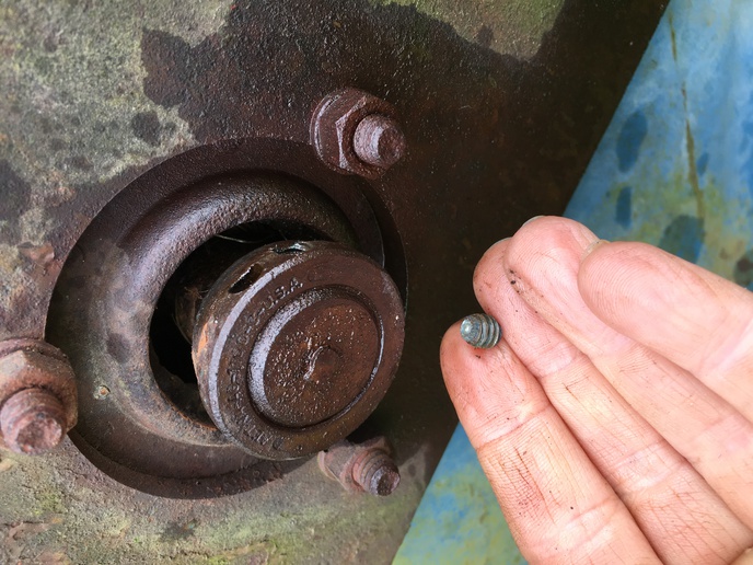

I calibrated the electronics on the rebuilt M&W PTO dyno and plotted a chart for my Massey Ferguson 65 gas tractor. It has a rebuilt engine, so the horsepower readings are pretty good. It's also a cold day. I haven't corrected for temperature and barometric pressure. I think I have a slipping clutch. I couldn't stall out the tractor.
