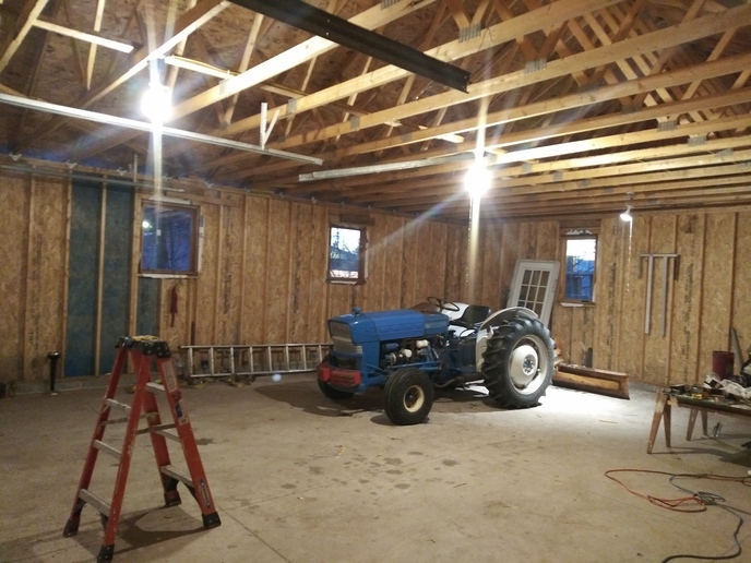

Assuming you have a 3 cylinder model 2110
built from 1965 to 75 then any 8 on 6"
bolt pattern will fit just fine. So from
1948 onward - 8Ns, Jubilee, 600, 800, 900
2000, 3000, the 4 cylinder 4000, 2600,
3600 and a bunch of other Fords and also
several of the Ferguson models all those
model tractor rear wheels are a direct
bolt-on.
Your 2110 was geared taller than those
others but if you have the 8 speed
transmission it will still have low
enough gears to be an entirely useful
tractor. There are a few guys on the Ford
forum that have done exactly that.
As for the front end being lower that is
not a big deal. I put those LCG spindles
on my 3000 just to get it lower.
Works good under limbs and branches, etc.
I have 12.4x28" rears on mine and suggest
you go no taller and no lower. Taller
tires will make your tractor too fast for
some things and lower rear tires will not
grip enough. I had 11.2x28" rears on mine
for a while and you'd better be quick on
the clutch if it starts spinning as it
would dug it self in till it was stuck in
short order.
I have other Ford tractors but use this
one the most.
