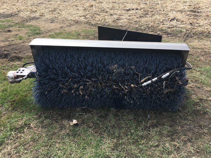

On the new used loader bucket the previous
modifier of the bucket made it so when the bucket
was attached to the loader there would be about 6
inches between bucket and the loader quick attach
plate so then all the force would be taken up by the
loader bucket adapter plate allowing the bucket to
twist the attaching plate when the bucket would hit
uneven ground . I had to cut the one side of bucket
attaching plate off because it wasn�t wide enough to
let the adapter fit up against the back of the bucket.
