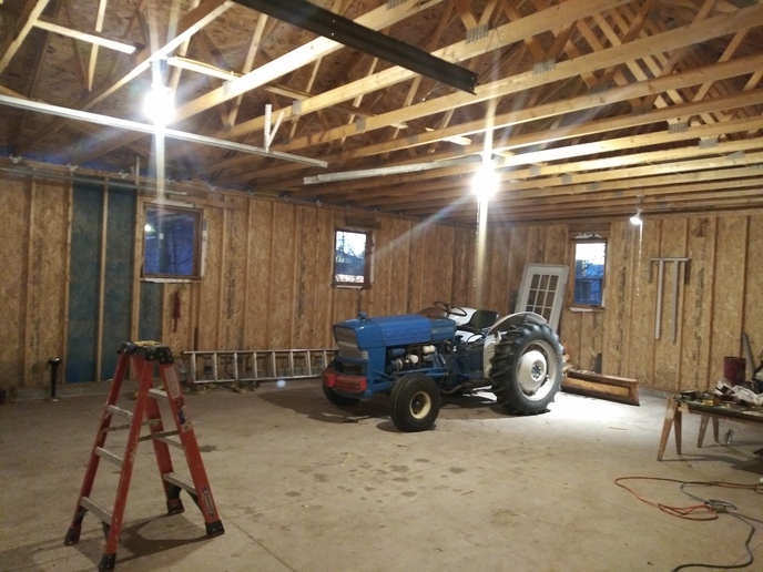

You could buy the parts to make an lcg
out of your 2000 very easily. I kind of
made my own that way. I bought the front
spindles from an lcg and put them on.
They were a direct, bolt on replacement.
They drop the front end about 4".
14" car tires on implement rims dropped
it another couple of inches. I run
12.4x28 rears on it instead of the
correct 13.6x28s. They drop the rear end
a couple of inches.
Don't forget about ballast.
Wheel weights and/or fluid make a much
more stable tractor.
With lcg spindles, your wheels set way
out, ballast on/in your tires your 2000
would stick to a side hill like a spider
on the wall.
