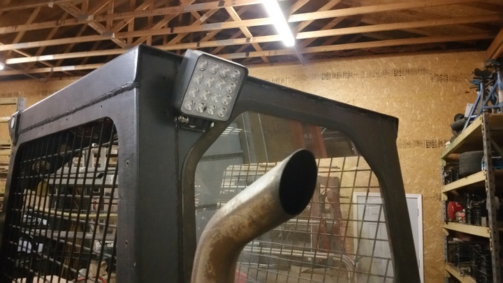

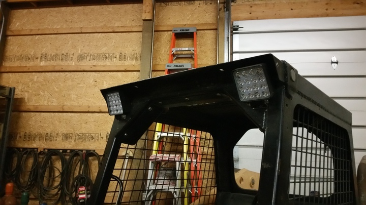

My Mustang had the same lights your Case has. I put 48 watt flood beam leds on it. They are a little over 4" square. I had to drill a new bolt hole a little lower than the original, but I just used the old hole to run the wire through.

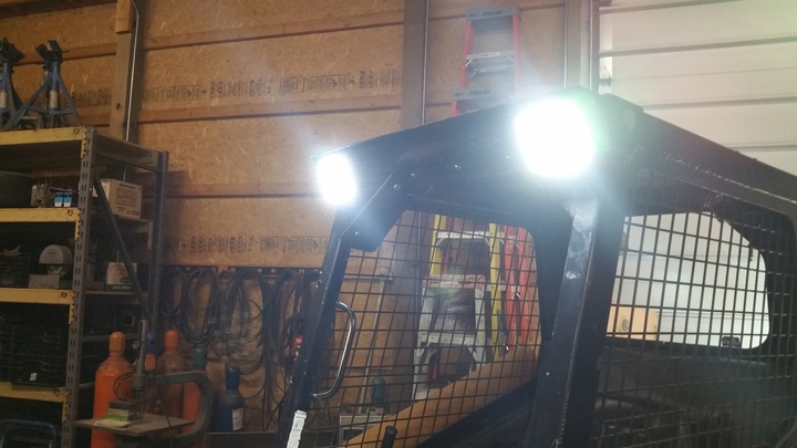

They are probably 10 times brighter than my old yellowed lights. I would say my only real complaint is the light reflecting back off the boom when you have it up in front of the lights can be a little much.
I bought 4 lights for around $30 on ebay. I also put them on my forklift.
