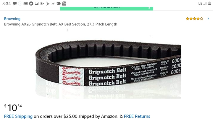

Thought of another thing to suggest. On mine I put a "Fractional" drive belt. They are more flexable and run quieter and easier. Many HVAC Suppliers have them. Also check furnace supply places. Make a big difference.
