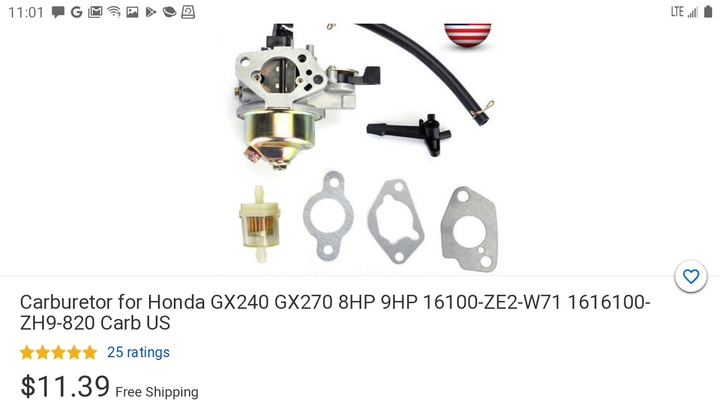

mentioned. He actually keeps a stock pile of spare carbs for their Honda
engines. Most of their stuff is 5 and 8 horse. Not even $12. Only takes 8 to 10
minutes to change. During the winter you can take them apart and swap parts
around till you get some spare good ones. I agree this stuff is just crazy. You

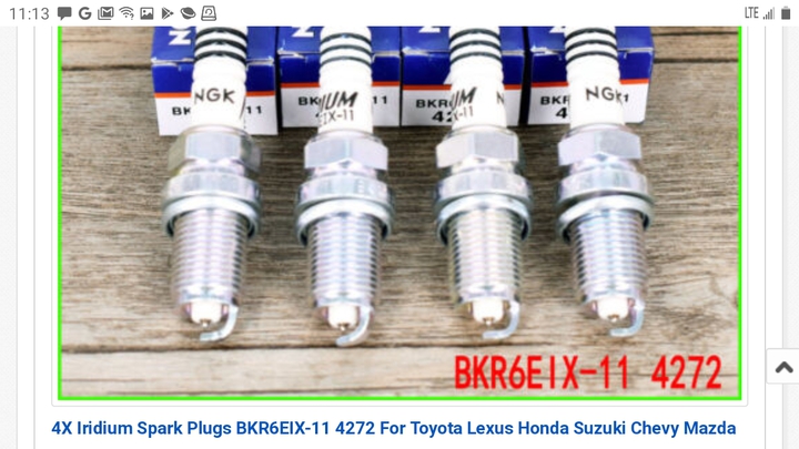

clean a few weeks ago. I ran my vacuum today and she popped off first pull.
Also installed the new NGK IRIDIUM plug. Beauty! Look on Ebay and order that
exact number in red. You also want that four digit number on the end. This is
the plug for cars and such and not superhigh performance race engines. You need
all of that number. Worth every penny. Takes the place of the champion plug #
RC 12YC. And several others. The straight NGK cross over is BPR6ES or BPR5ES.
