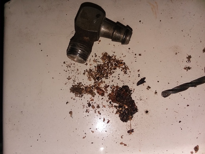

Last year I had trouble with terramite
dying under heavy. First I thought it
was low on gas. Come to find out
The elbow at bottom of tank was choked
with crap.
I had similar problem with the elbow on
Jubilee carb.
