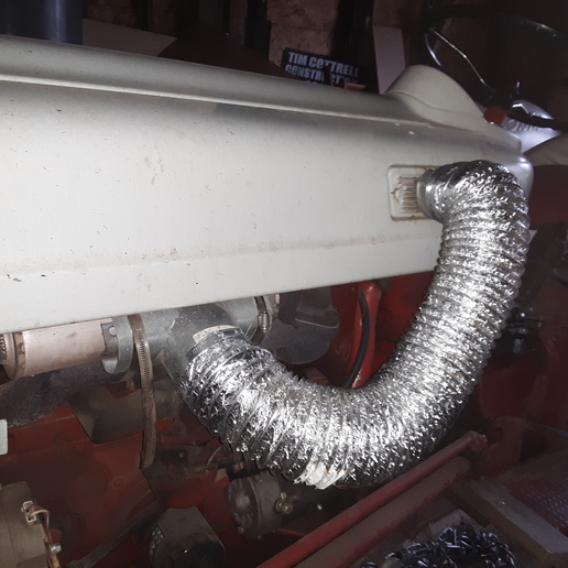

It didn't want to make power. So I put on
4 inch flex hose and cranked main jet out
a half turn.
This happens every winter.
