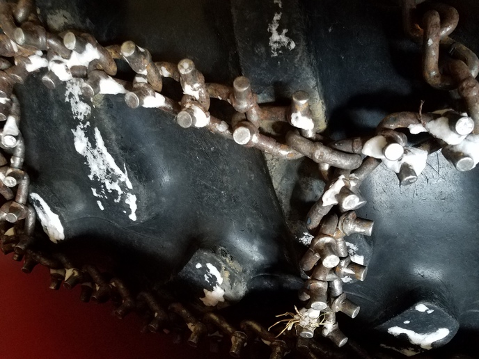

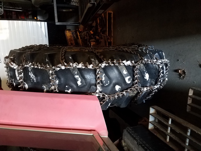

These will get me to where I need to go.
I put them on with a rope. Lay the chains down outside up behind the tractor. Tie a rope to the end and run it over the top of the tire, tucking the loose
end under the front of the tire. Then drive forward pulling the chain up over the top and around.
