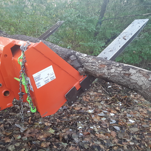

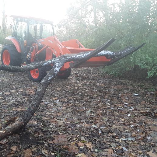

Decided against buying forks or a grapple. Factory forks I looked at were 44 inches wide. Grapple too expensive and I need forks to lift objects to loft in new pole barn.

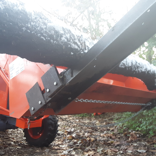

So I took homemade forks I've used on terramites. Bolted brackets inside of welding incase I want to use them on terramites.

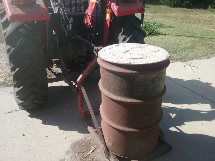

The Kubota has enough guts to lift rear wheels off the ground. If a 500# ballast I may to make another concrete 55 gallon ballast.
Also need to make a brush guard to keep logs/brush from going over the bucket.
These forks can easily and quickly put on and removed.
Factory forks, total weight around 300#. I really don't think I could a single fork.
