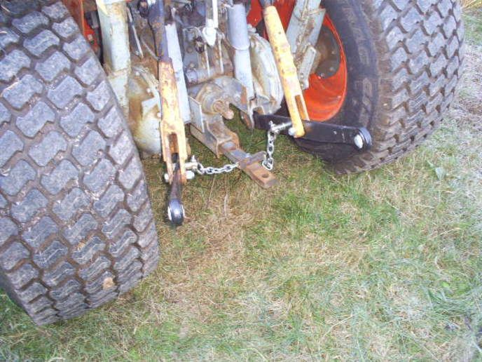

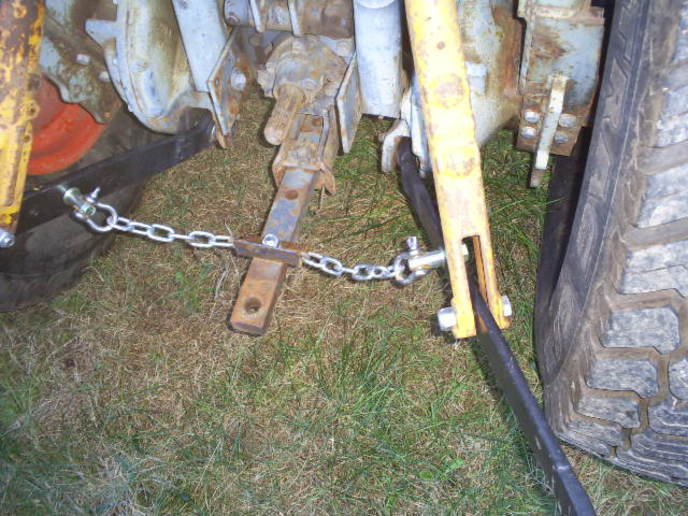

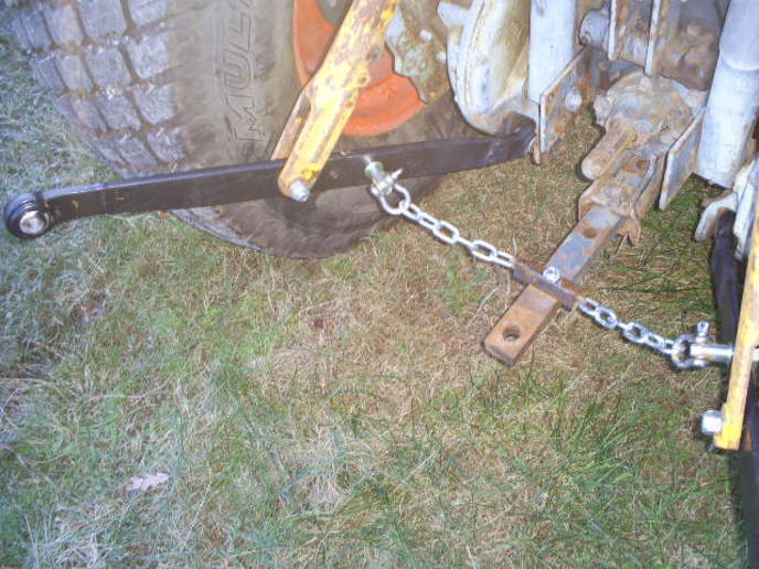

I recently bought some from TSC and cut them and modified them to fit my Kubota L5030.
They were not expensive.
Tractor did not have them when I bought it.
It was used pulling an irrigation trailer on golf courses when they put in irrigation lines.
I cut the arms I bought and welded them up with 7018 AC rods.
Was easy to do.
Got stabilizer bars to put on now.
Also modified the old yellow links that pick them up.
They had been in my barn forever.
