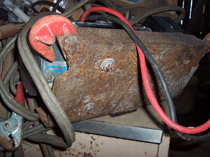

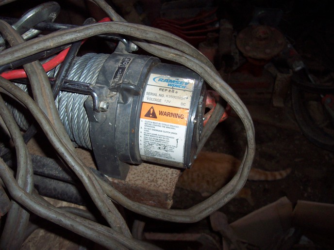

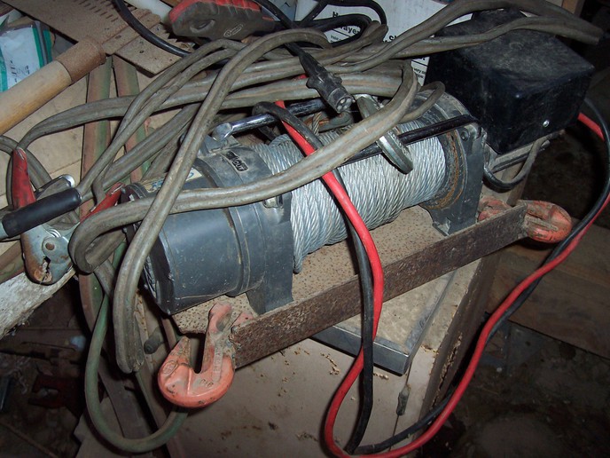

the winch is a 12v Ramsey from Northern. I mounted it on an 8" channel and welded grab hooks on the corners so I can use short chains thru the front stake pockets to pull against while loading, and take it off when I don't need it.
