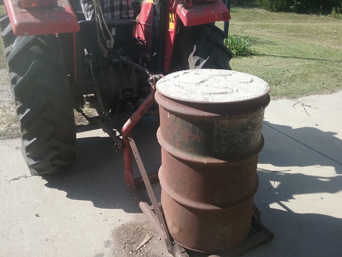

I prefer not to use tire ballast, instead I want rear ballast behind tires. Two reasons. Rear ballast can easily be removed when I'm mowing or transporting tractor.
Best reason is tire ballast doesn't transfer weight off front wheels and front axle. Rear ballast will
This is a pic of rear ballast I made for neighbor. He discovered tire ballast did not to remove the weight of round bales of his front wheels. 55 gallon of concrete set back did the job.
Now I need to make a ballast for myself.
