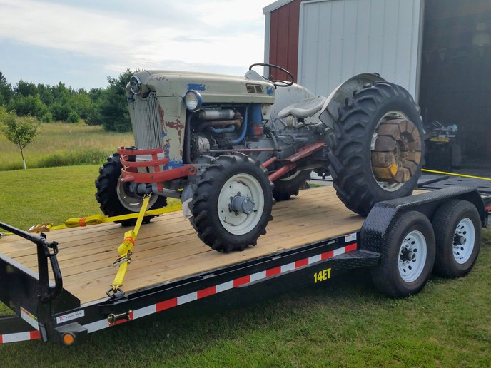

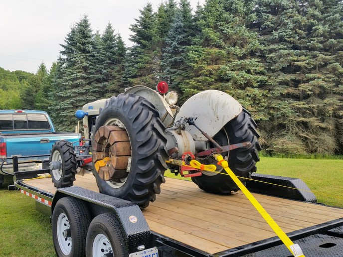

I bought four 24" long by 2" wide axle straps from my local Menards and loop them around the axle. They have metal D ring at each end of strap and work great and would not scratch paint if you have a show tractor. I then use a strap at each corner of the tractor.
