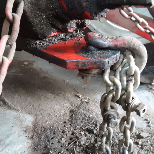

I think a few days ago you posted about modifying hitch on Ford.

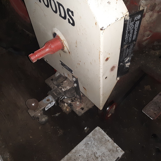

I had to remove drawbar to install 6 ft woods mower on Farmall. Bought a 2 inch reciever for HF and attached it to
Tongue on mower.
My Jubilee has a half inch metal plate for hitch. You could easily weld 2 inch reciever to metal plate.
Then you can buy adjustable receivers.
Hope this helps.
