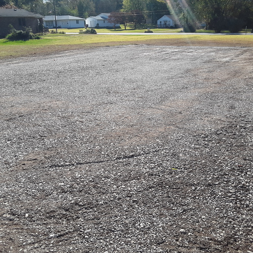

After a rain I roll pole barn site.
Fill in the low spots, roll again. Got it within quarter inch. Hopefully contractor will get it built before winter sets in so I can get the floor poured.
The gravel on the end isn't pack because that will not be under the floor. Covered it
With gravel to keep contractors out of the mud.

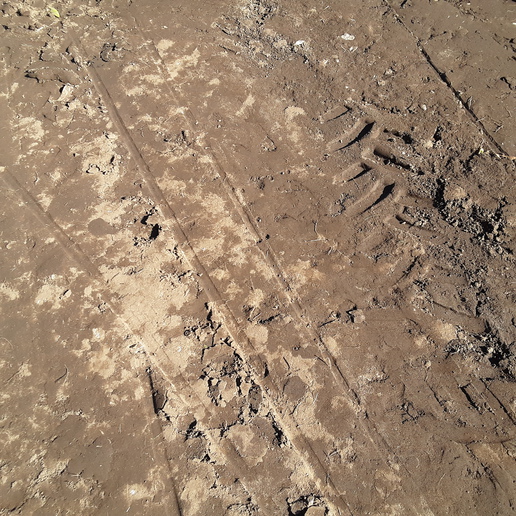

This is what roller does the dirt.
