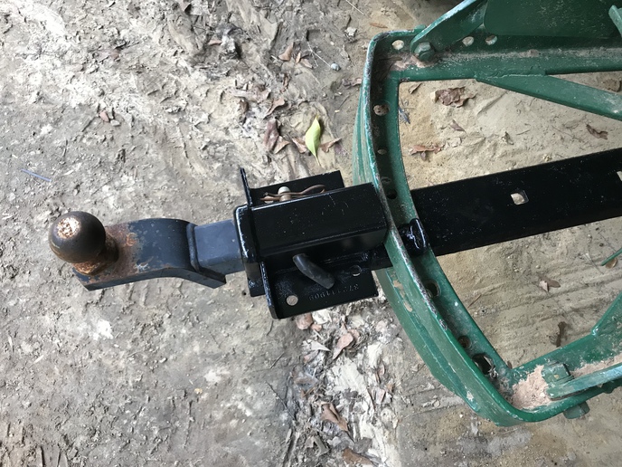

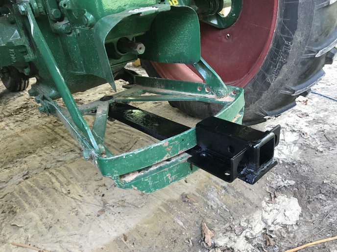

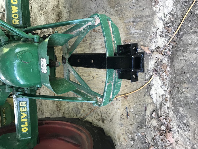

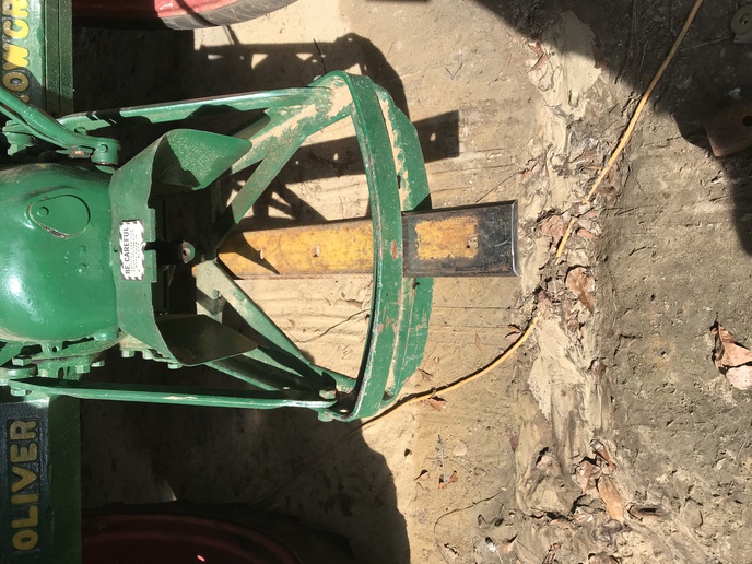

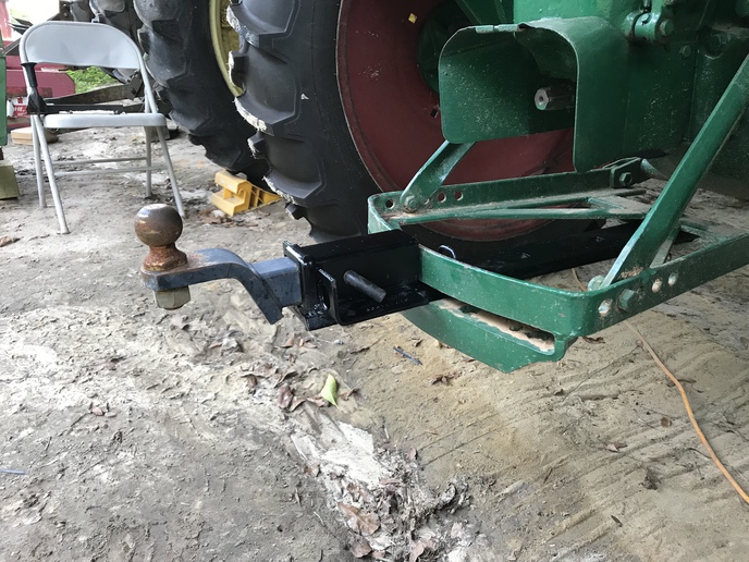

Needed a drawbar, made one!
Posted by grayrider on October 22, 2019 at 15:35:41 from (107.77.236.144):
Grandpa Love�s old Oliver 77 is in my care now, upcoming hayride resulted in me building a drawbar for it today as Oliver parts are non existent in south Alabama and I didn�t want to order one since I had stuff laying around. Used a grader blade, cut it to size, welded a receiver hitch to it, fixed it with two pins for easy removal, can swing it side to side or even flip it upside down if I want too. Will probably get some criticism from the Oliver purists but it�s the way I wanted to do it and being 100% authentic doesn�t matter to me...
