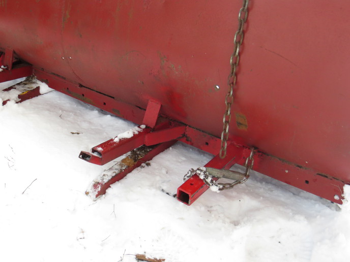

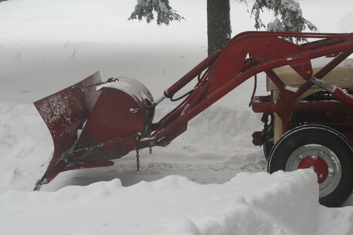

Here is how I hook up to the snow plow,I stole the idea from the big parking lot pushers.
Just drive up to it, lift and hook the chains.
This shows the pickle forks and chains. I no longer have the 2 n with Wagner loader so I modified it a little to use with the wider bucket on the 1710 buy adding the short 2 x 2 square tubing and relocating the chains. The spring on the chains holds tension so it doesn't fall out of the hooks and makes it easier to hook up and unhook. Works for me.
