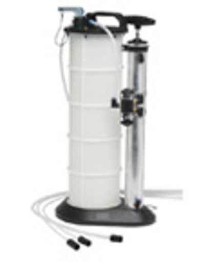

Did my car a couple days ago.
open the hood
stick the tube down the dipstick
give the evacuator a few pumps
unscrew the top located filter housing
replace filter
pour in 5 qts mobil 1
and flip the switch on the evacuator to put the used oil into the now empty 5qt jug for drop off on my way home
