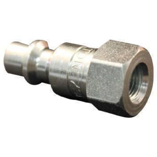

Dave there are several styles that lock on or thread on. The one I like for smaller tires is the Milton S-693. This is a straight chuck. It has circular rings on the inside. So you push it on and then push it over at an angle to the vale stem and the rings will hold it on. This will flow enough air to keep most smaller tires inflated. These cost about $10
On larger tires you can need more air faster to keep them seated. This would be semi truck size tires. I like the Milton S731 fitting for this. They work IF you are using "M" style air couplers. On these you remove the core and then screw the fitting on the stem. They will fill a tire really fast. You can install the core through the fitting and then screw it off. These fittings are $4-5.
Then to make putting the cores in faster you need one of these handy tools. It has a small end for the regular valve cores and the larger end for some larger cores on flotation tires. You can spin the tool between your fingers and quickly install the valve cores. Milton S-444 cost about $3-4.
