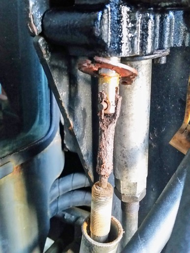

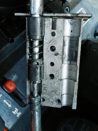

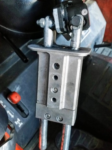

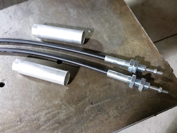

I replaced both cables on my joystick on my Kubota B3030 with a cab. Wasn't too bad of a job. Not sure if your set up would be the same, but if not it is probably similar. I found it easier to remove the joystick and install the new cables at the joystick end first, the install the end at the valve. Here are pics of mine, I had to replace the cables and aluminum cups at the valve end.
