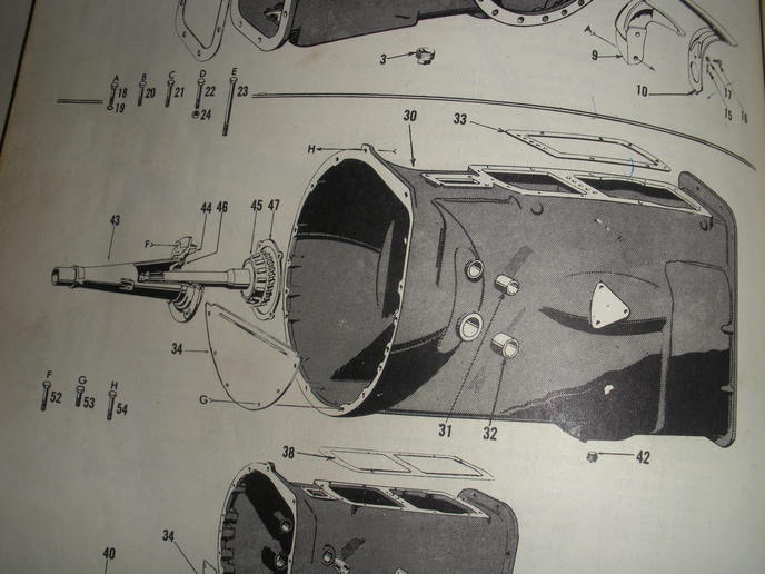

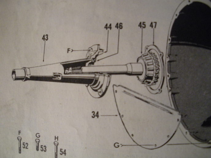

As per Parts Book........TE 20....TO 20...TO 30...TEA-20....all have the same parts as per IN PUT SHAFT:
#'s 43-44-45-46-47
# 46 OIL SEAL...Part # 195 760 M1
Ferguson started out (Coventry England) with a Continental Engine.....then changed to a "Standard Engine" (Coventry England)
Ferguson Tractors assembled in the USA.....Continental Engines....
I have no idea if the above Part # is still a good number...
